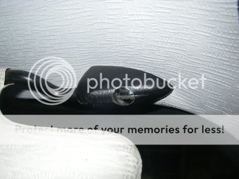

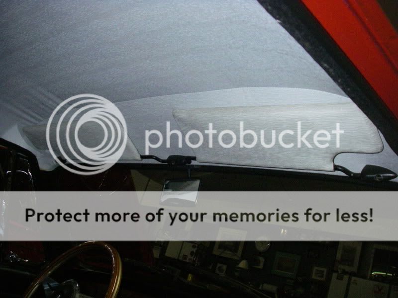

Tom, your memory is correct. Um, the mounts are different looking (to be sure). All holes are in the window frame. As I recall there were no more than the three seen for the visors and the two for the rear view mirror. Hopefully these photos will help. The visors and hardware are original - my headliner is NOS. As you're aware, the headliner in the front is tucked under the windshield gasket. I'd try hard not to peel it out of there (it was hard enough to make it a neat installation to begin with). I found the holes by remembering where the center hole was (it's in the center), then using the visor rod hardware go out from there.
Whoops. While I was busy posting, I think you found your answer.
So I guess mine only has 3 holes, and drilling would be required for anything newer. Since my headliner is modern headliner foam, I took a pin and started stabbing anywhere I thought a hole might be, and only found 4 (the middle feels like there's two instead of one). That's how I was able to install my mirror.

The visors in our Mk1 look like those shown in Jay's photographs.
