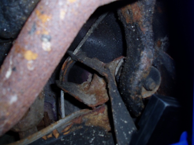

Here's the best I could do. The lower line is fuel. My car is a late one. Earlier cars were different.
Thanks very much for the pic and the effort!
I am having a bit of a time orienting exactly where this is on the car.
Would it be possible for you to give me a brief explanation?
Line comes straight down from the tank then makes a 90 degree bend and goes along inside of the frame the frame fold. Nowhere over the axle that I can see. I'll try to get a better pic later today. Car is presently on a scissor lift in my crowded garage and access limited.
