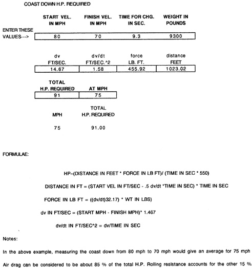

I was also curious about air drag vs H.P. on an actual vehicle. In this case, an RV. You can come quite close by measuring the coast down time between two given speeds. I set up a spread sheet with formulae & plugged in the stop watch times to coast down at various speeds. Transmission in neutral to remove engine drag effects. This has proven to come pretty close to known numbers. I have attached a pic of the spread sheet & typical numbers. You should be able to work back to drag coefficient from there.
There are some dashboard dyno gadgets available that will give similar information & more.

The TRUE aero drag coefficient of a vehicle is a very elusive thing. Advertising hype & wishing often substitute for real numbers. A small error in this number can result in a very large error in "required horsepower". Just because it is in vogue with magazine & advertising writers doesn't mean that the numbers quoted are significant.
D
