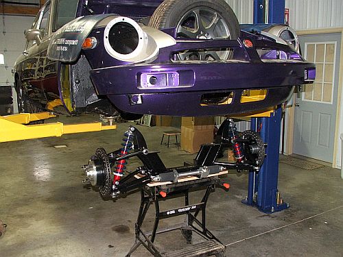

Yes....I have FastCars, Inc's front crossmember on the front of the GT. It is about #75 lighter than the stock crossmember as is literally a bolt-on piece. Its geometry is based on that of a BMW M3. This piece transforms the handling of the B/GT..It's not cheap...but in my case, felt money well spent. An easy conversion for the home mechanic.
See: https://www.fastcarsinc.com/

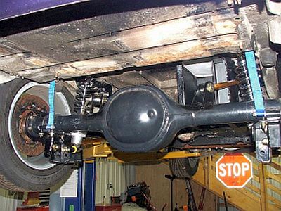

On the rear, I used Classic Conversion's (Bill Guzman) four-link rear suspension (attached to a narrowed Ford 8" differential. This was a little more than a bolt-on, with some welding and fabrication required. Install time was the equivalent of about 8 hours (at home, with a two-post lift at my disposal - install time may be increased if you are using jack stands.) The kit is designed for a chrome bumpered MGB...the battery box of a rubber bumpered MGB interferes with the travel of the top link on the right hand side. A simple fix by adapting the battery box with some scrap angle iron and a welder. The kit is well thought out...and lowered my GT by about 2"...and I still have more adjustment available if I need/want it.
See: https://www.classicconversionseng.com/toppage3.htm
I also used Hap's (Acme Speed Shop) 15" Charcoal Superlites to put the rubber on the road. Hap is a member of this forum. (Note that this is NOT the wheel that is shown in the FastCars picture).

Here's the four-link installed.....
