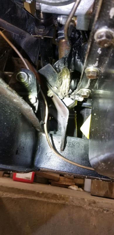

Thought I might have a better picture, but this is all I can find for now.
I used a braided strap to a body mount bolt and made sure I had a good clean metal-to-metal contact at each end.
Not original, but not very obvious and most importantly for me it works well.
