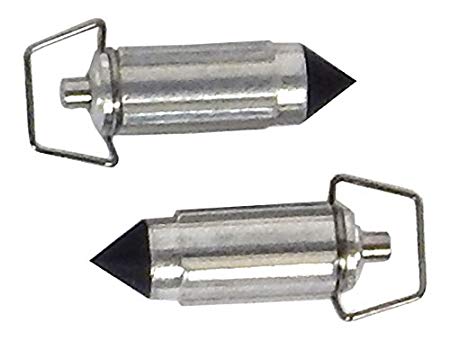

If the Viton tipped valves stick for you, there are two options I know of. The first is to carry a small dead blow hammer and tap the top of the float bowls before trying to start the engine. Sometimes it works, sometimes it doesn't. The second choice is harder to implement. On my Mini's HS2s I made a pair of "clips" out of music wire. They loosely connect the float valve body to the float arm so the falling float will pull the valve open. This is similar to what happens with Briggs & Stratton carbs.
The image below is for motorcycle carb float valves with similar clips to those I made.
