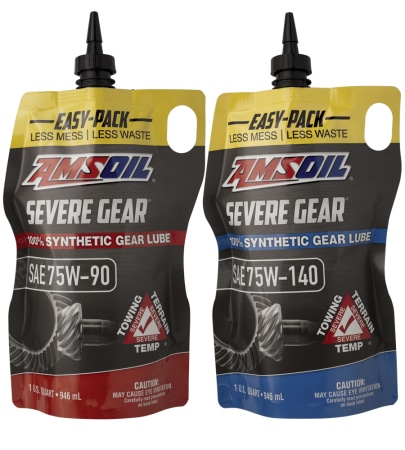

For the 2 1/2 quarts that the tranny takes, you might as well just change the oil. Refilling is a bit of a pain. A funnel with a flexible hose makes life a bit easier. I put a little bit of Seafoam into the tranny when I changed out the oil. It may be completely psychosomatic, but it sure feels like the transmission is shifting smoother.
saw this on another forum
2 1/2 Pints. Just a little over a quart. Been adding a straight US Quart to trans since forever with no issues.
