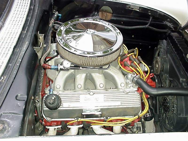

Jumping in, the answer is yes. 12v electric fans can pull over 30 amps at startup. The Rabbits used fan relays (oh, the memories) and of course modern OEMs use relays. I have a couple of Ford factory fans and they pull over 75 amps at startup. I prefer used OEM over new aftermarket for longevity but it can be hard to find one that fits. Ferzample, a Taurus SHO fan in a '58 Ford with a 460.

The regular Taurus has a two speed fan IIRC. I have one here. Every fan that I know of uses a relay except for those that use modules like the Taurus. I can't remember if they used a relay too. The Rabbit uses a standard Bosch "regular" size relay which should be universal across the automotive spectrum for most of the older stuff. By older I mean as late as 98 or so. Lots of them switched to the smaller mini relay size which I also believe is a set standard. Don't hold me to that as I could be dead wrong.
