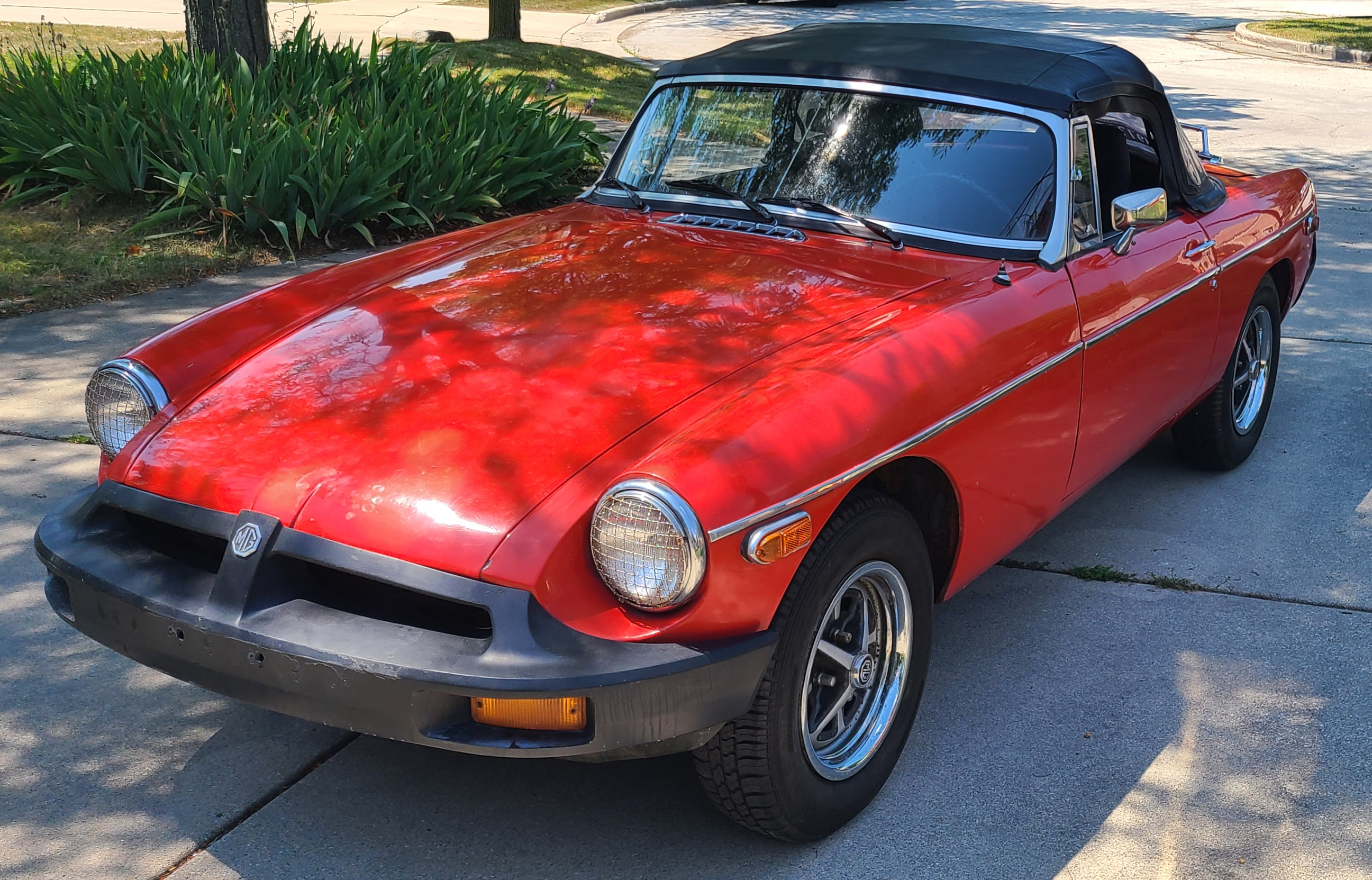

I am a college student and purchased my first car -- a Flamenco Red '77 B -- back in June (2023). It was a runner although it had a lot of deferred maintenance items. My plan is to repaint it with a fresh coat of Flamenco Red and freshen up the interior next summer. Meanwhile... (That's always a good sign.) I seem to have acquired a second B... A '79 someone painted Pewter Metallic along the way. It was offered as a parts car and supposedly had a blown engine... But as of today (9/9/2023) I got 'er to run for the first time in over a dozen years. Life can get interesting at times.

Welcome ! From the looks of the paint it seems that a good buffing and polish will suffice. I have a 77 B that I just spent about $4000 on. Weber carb, bushings, fuel tank and engine mounts. Runs great. Find a reliable honest British car mechanic and hang on to him. The priority is safety, the body issues come later. Good Luck!

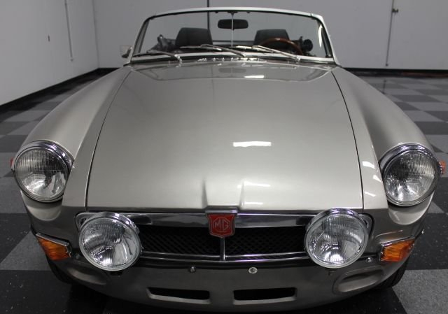

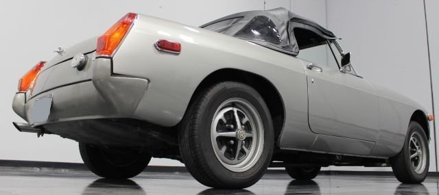

Turns out the '79 "donor" car was arguably in slightly better shape than the '77 -- except it did not run, mice had eaten it's wiring, it had no bumpers, and four flat tires... But I got the engine to turn over using a bunch of Mystery Oil, time, and a long breaker bar, found bent push rods, replaced them, cleaned out the HIF 44 and replaced all the seals, made a new electrical harness -- copied from my '77's -- set the timing, and the lash and the engine now runs. Now, I have to steam clean the fuel tank and replace the tires... then see if it has brakes.
My '79... Finally got her up and running today (9/20/23). As stated, WAY too nice to be cannibalized.

awesome! that rear bumper is a great solution!

The valances / bumpers are from a PO, made of fiberglass, and of unknown manufacture. The back one is mounted using stock bolts and wood spacers epoxied to the valance. The front one is mounted to the body just like the shorter stock valance using bolts through fender washers and rectangular steel backing plates. The frame ends were cut and light mounts were constructed.

I certainly hope you are going to use your skills in restoration. This looks great. Need engine room pictures too. Great work!
