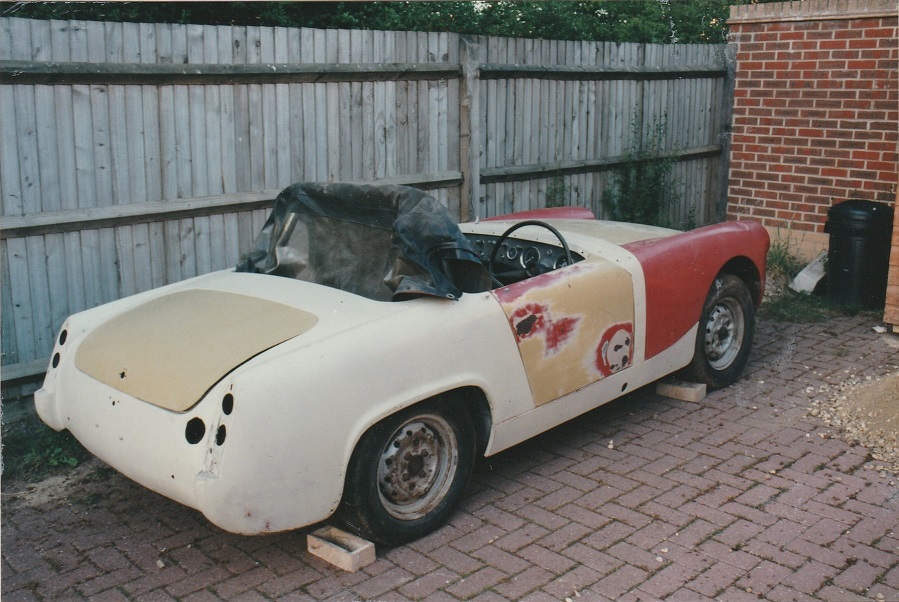

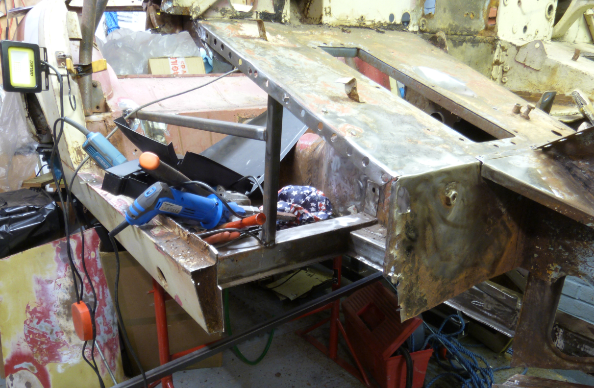

Thanks for the welcome. Two photos for now, the car as I collected some 25 years ago. And is it is right now. The car is pretty rotten. The tunnel, chassis rails and cross-members are pretty sound. The sills are semi-sound but awfully applied. I have the car level and braced in the corner I am working right now. The plan is to rebuild a corner at a time. I'm doing the front corners first. Once they are done I will add more bracing and tackle rear floor and sill replacement. I've measured diagonals/levels carefully and found the shell is surprisingly straight.
My ambition is to get to a body that has a few scars, but is rust free and epoxy painted to prevent future issues as much as possible. The panels and seams should still look as factory as possible withing reason. There will be bolt-on upgrades to engine and brakes but nothing irreversible. The beige paint is primer applied by a previous 'restorer', presumably to hold moisture nice and close. The red was a respray colour, inner panels review a nice Iris blue.

In the second picture - where's the car? :oops: By the way, welcome to BCF!

I see the need for the braces. Looks like you have made a good start.
