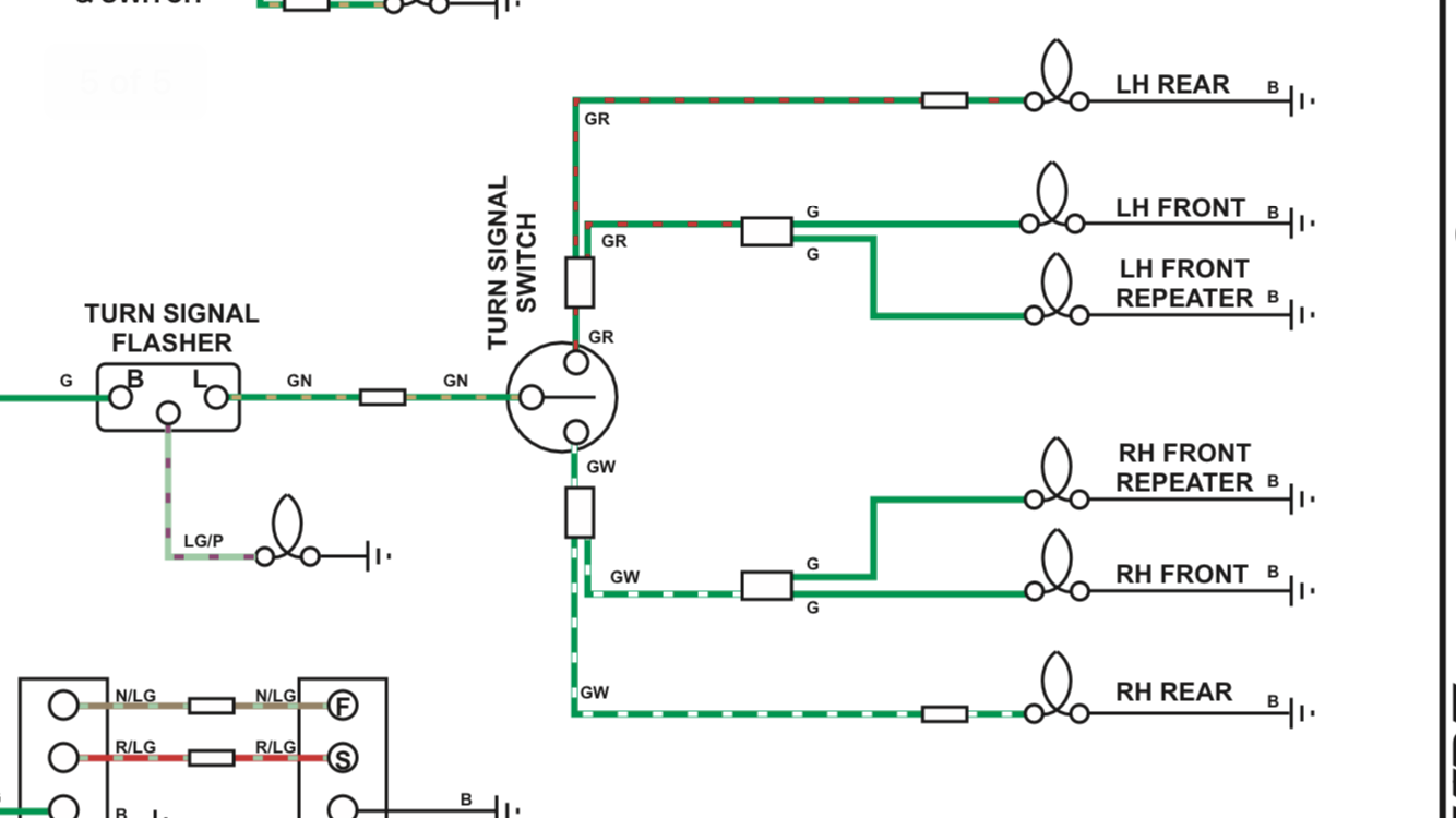

Per the wiring diagram, if the lights themselves are flashing, it looks like the flasher would be the the culprit. The flasher provides on/off power to all six bulbs via one pin, and on/off power to the dashboard bulb via a separate pin.
If that’s the case, I’m not sure why the flasher units keep dying?
From http://www.advanceautowire.com/tr24a.pdf:
I'm gonna guess a bad connection at the socket. It might just be that the flasher seems to fail, then you replace it, and the new one works because disturbing the connection fixed it awhile. But, yes, it seems unlikely that it could be anything but the flasher, the socket, or wiring to the bulb.
