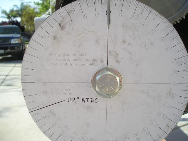

That's right. The method you used to find TDC on your degree wheel is not nearly accurate enough to do this job. You could be off by 8 deg. or more with this technique. It doesn't look like much movement of the piston but the engine isn't going to run the way it should if you're off by that much. Find out about the stop method and make sure you've got TDC located correctly. Then set the cam to the spec's. Setting based on crank angle at 0.050" open is OK (note that is usually 0.050 valve open with zero lash - not cam lift). If you are going to set it by peak opening, you can't just look at the dial indicator and try to guess where the peak is - you'll get the same inaccurate answer that you are getting with the piston. You'll have to look at lift on both sides of the peak (where it is moving enough to measure on the dial indicator) and then do the math to see where it was at the peak.

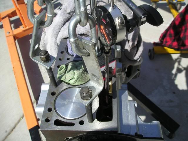

If I remember the stop bolt technique correctly, the stop isn't at TDC, which is why the height of the nut/bolt isn't critical. You set the bolt, rotate the piston until it stops and mark it on the degree wheel. Rotate the opposite direction until it stops and mark it on the degree wheel. The point directly in the middle of these two points is TDC. Without going back and reading it, I think that is also how it was described earlier in this thread.
As far as being better than a DI... I found it to be easier, quicker and at least as accurate as the most meticulous DI set up.
BTW, here is my bolt stop...
Roger said:
Getting it so it just touches and no more is the way to find TDC,
I disagree. I believe the most accurate way is to find a spot on either side of TDC and mark the degree wheel there. TDC is then half-way in between. You can use a stop as Swift6 and others have described or you can use a dial indicator. The way to use the dial indicator is to pick a depth such as 0.100" below TDC (the exact value isn't critical). Mark the degree wheel at 0.100" as the piston is on the way up and mark it again at 0.100" on the way back down. TDC is half-way in between. There is so little movement of the piston near TDC that trying to tell when it reaches the peak is really just guessing - or at least this has been my experience. YMMV
