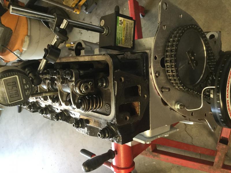

Final camshaft update... it is installed and timed! BIG tip of the hat to Richard Good at goodparts.com for being so responsive and helpful through the process. Multiple exchanges with him helped assure me that I was on the right track. Timing ended a little advanced from the GP3 spec sheet which called for 6 degrees BTDC at .050 lift. Richard said “In my tests 2-4 degrees advance was all gain.” Mine ended up at 9 degrees BTDC, i.e., 3 degrees advance. The owner of the machine shop that got my block and head ready also said every single engine he builds is advanced at least a couple degrees.
