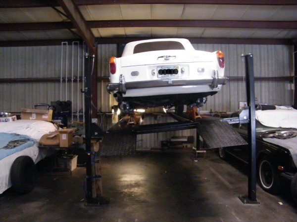

From pal and former partner. He's got a Rolls on a drive-on lift, doing brake work. Lift cable BROKE with this as result ( no injuries!):

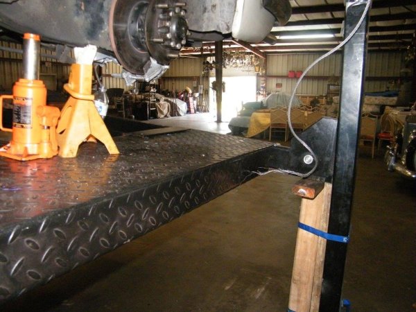

It took a call to the outfit that installed it (2009), a forklift and a LOT of effort to get the Corniche down without damage. This is the second lift to fail with a large car on it in our total time working together. Scary stuff!

Should always be setting on the safety stops instead of the cables except while raising or lowering. Of course maybe it was "in the process."
Customer was IN the car, it happened as it was being lowered.. safety catch did engage but with the distortion the best plan was to brace it before anything else.

Hmm, what is the capacity of a typical 4 post lift. I think they may have pushed that one a little too far.
Having said that I do remember that there were two rating organizations that rated most lifts sold in US. I believe the one organization would guarantee that the lift had been tested to twice its stated rating before they would put their sticker on it. But I do know from my own searches and purchases that not all lifts got rated.
Chinese lift?
I bought my Danmar 2 post lift about 5 years ago. At that time during my searches I only came across 2 lifts that were made in the US. And they averaged about double the price of all the other lifts. The one lift that I was very interesting in was Rotary. They were originally made in USA and were well known to be very good. At the time i was shopping it became evident that even the Rotary lifts were not made in the USA at least not all their models. And not the ones I could afford. But I also discovered that there was a rating system. Two organizations and at least one of them rated safety and breaking capacity. Not all the lifts on the market were rated or stickered from these organizations. I don't recall and not in view of the raters names. The Danmar 10K lift that I bought was rated by both. You did pay a little more for the ones that were rated but I believed it was worth it.
