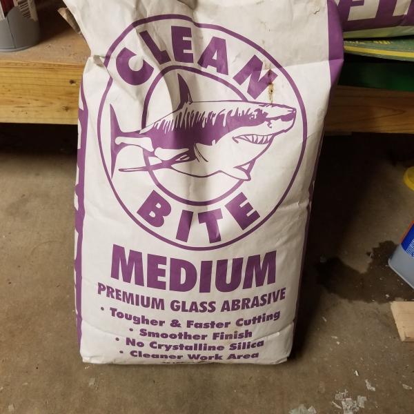

I have been using Clean Bite medium from Northern Tool. It is recycled glass and you do not get as dirty as you do with Black diamond. Also I have found it seems to flow better.
Cuts fast and gives a great finish as well. I put a blue tarp under the parts I am blasting so I can reuse most of the medium.
