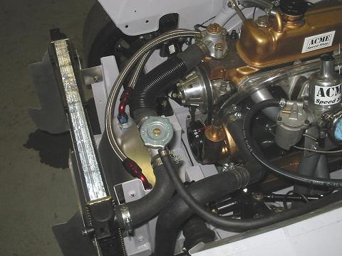

Winner's Circle ( https://www.spridget.com/ ) sells Ron Davis aluminum radiators. You might give Dave or Rob there a call. Here's the one going in my '62 Sprite:
Ray

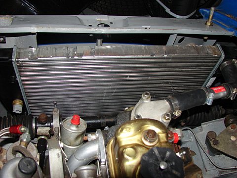

I run the VW radiator, the Valeo brand, plastic side tanks, aluminum core, it weights like 5 pounds, cools like nobody's business, but it's some work to install, I get rid of all the factory radiator shrouding to install it.

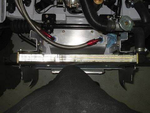

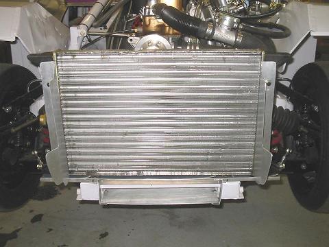

Branson, here are a couple of mine with the Jetta radiator installed.
Jeff
