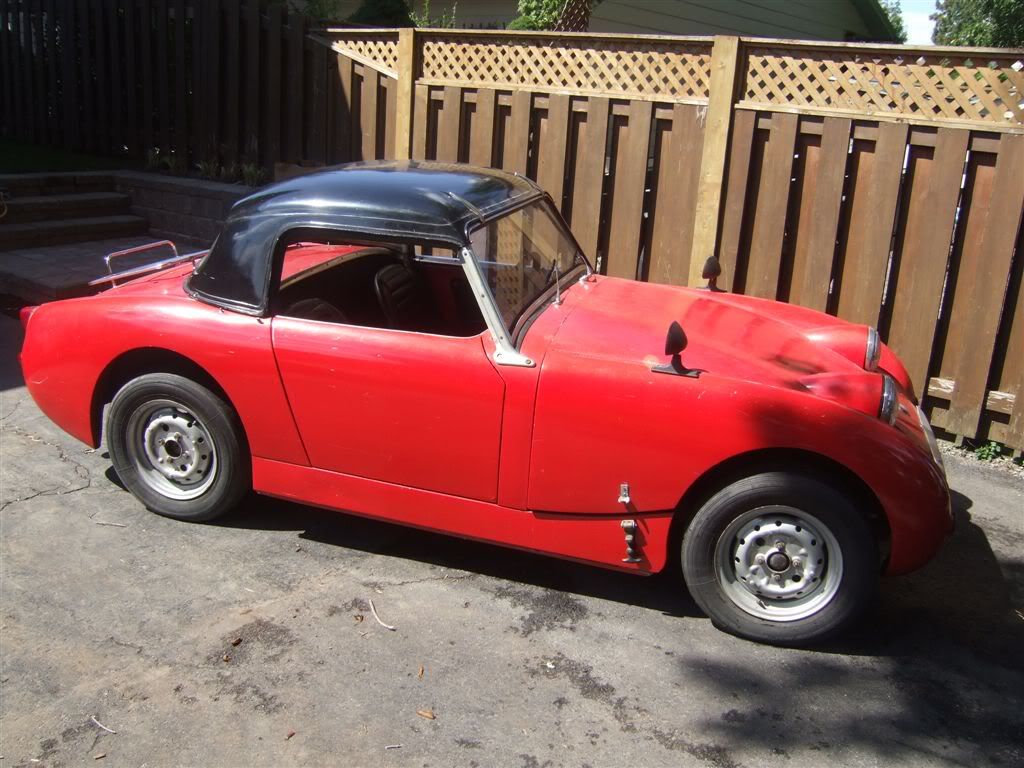

Looking at the interior, it looks to maybe already have a five speed conv. If it does, there is another grand it is worth. With the pictures, if there isn't any real rust issues, the car is worth the money. It has already had the later masters put on, probably when he did the disc brake changeover. What about all those switches on the upper dash? A very interesting car. One last thought. We get into this discusion which has only one answer, and that is what you want out of the car. If your dream is to have a "stock" car, this is not the one for you. But, this car has been modified to make it a more roadable car. It is not stock, which I see as a good thing. Also, a hardtop is also an asset for.

Body structure is quite similar to the later Midgets, so all the usual things to look for apply. I'll agree with the above, if the car is structurally sound, than 3-4k seems in the ballpark -- though local price issues always apply. 1275 and discs don't really affect the price much either way with Bugeyes, as lots of folks make those swaps (and they are reversible if desired).

Poke around the rear spring hangers and boxes. If there is rust through there, then the car will need tedious replacement panels/boxes welded in.
Is it just me, or does the curve on the front of the sill look a little flat? Maybe it is just the shadow.
The dash has been modified but I see nothing wrong with that unless you want it to be an original show car! There is quite a list of things that are unoriginal with it, including the wrong seats, steering-wheel, later power-train etc. For a daily driver with a lot of fun potential I would say it is definitly worth some consideration! The lack of a complete cooling/heating system is a bargaining point on price (lack of a heater might concern me if I were in Canada!). As stated above, check for rust at the usual places, i.e. the rear suspension attachment points and rust in the floors and rocker panels (though they look pretty good in the pictures).

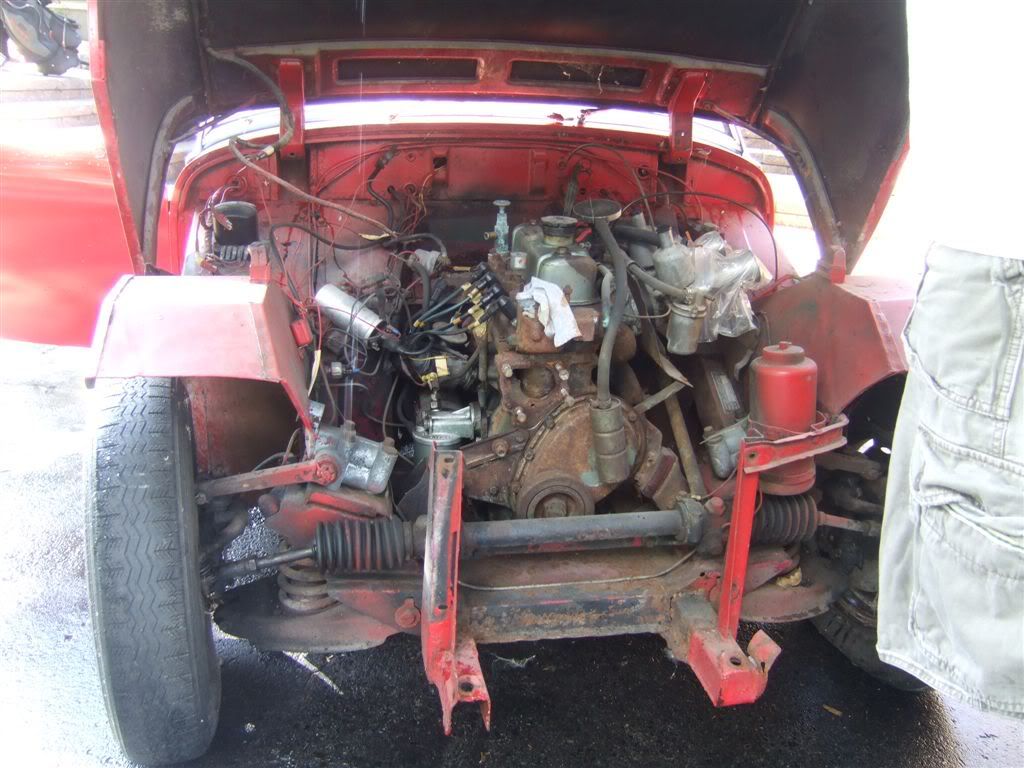

From the pics, looks like the front suspension bushings have gone... the BEs don't have more camber than the later cars by nature, do they?
Noop, but 50 bucks will buy all the rubber bits.
A frames and such extra of course.
The BE had a metal cage which the shifter boot fit on. Yours has just the leather wrap to the shifter. The conversion makes it very hard to use this metal part. If it has the five speed it will have the H shifting pattern and a five gear up and to the right, reverse right and down. If the car is a roller, you could check and make sure it is in gear in each of the gears. The conversion has a transition plate between the tranny and motor that is about 1" aluminum. God luck....
