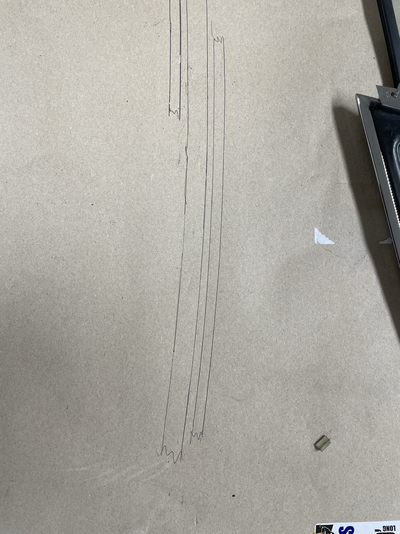

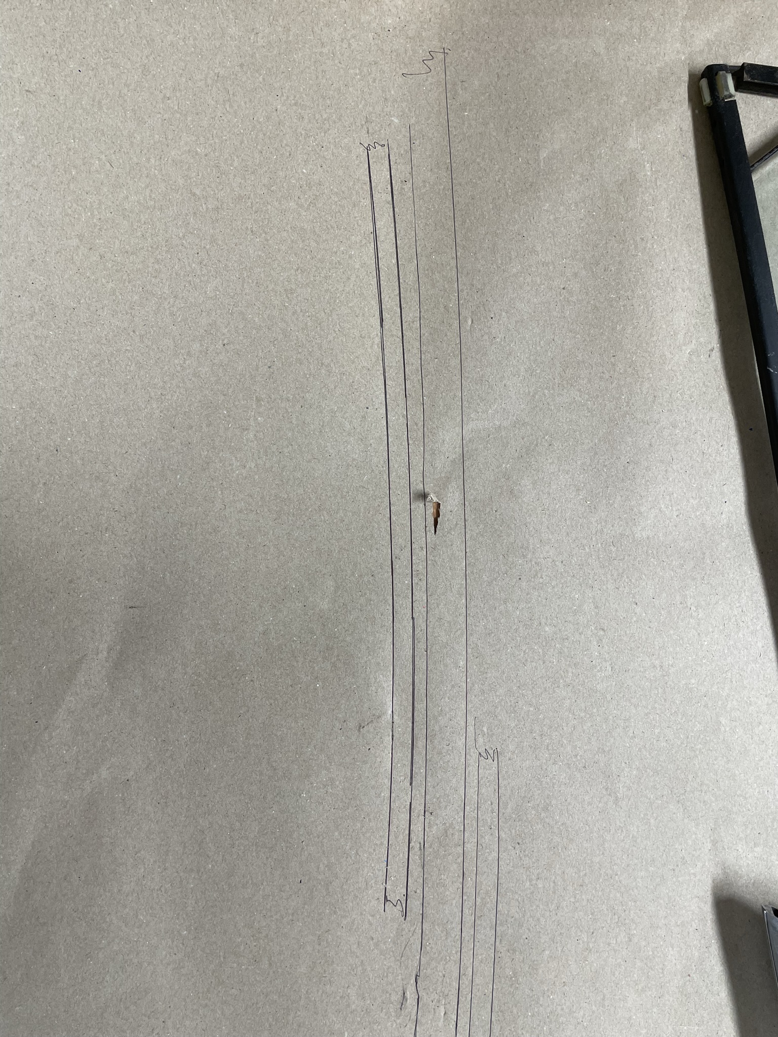

Attached are two photos showing the curvature of the front window track compared to the door glass with its metal guide frame attached. On both photos, the door window is placed on the upper and lower halves of the window track. The curvature is definitely different and that could be contributing to my gap of the rear upper part of the window not being close enough to the weatherstripping.
Not sure how to adjust the brass window track, but it can be adjusted, right?

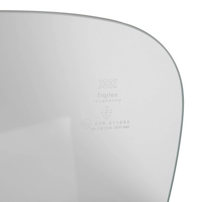

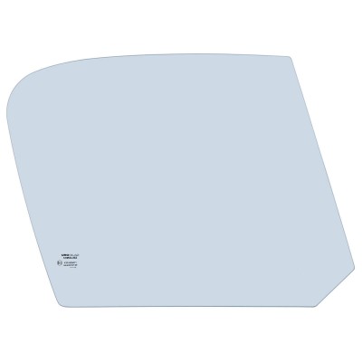

The aftermarket glass moss sells has a different color tint vs XXX. If I remember correctly, you'll see it at the edge of the glass.
It doesn't have the XXX information on the glass. It's information is in black on the lower area of the glass.
The XXX glass Moss sells, it's information on the upper area of the glass.
Maybe someone will chime in with information about what factory glass had printed on it, placement and color.
There's also after market glass with no information printed on it.
