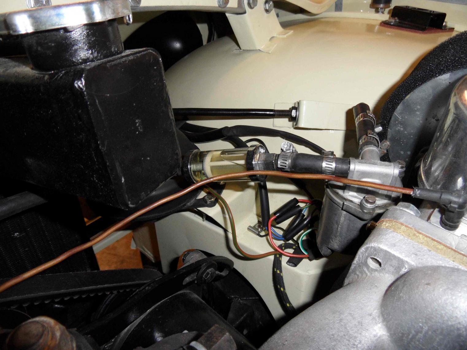

This probably is a real stupid question. I replaced my fuel filter with a glass one so I could check when it got dirty my question is the whole filter to be filled with gas ? I took it for a quick ride and was hesitating as if it was jerking as if I was running out of gas but when I stepped on it hard it ran strong?I looked at the filter when I got home and it was only half filled with gas? Thanks Sundown

The glass filter on my SP's have always looked full. But...I have never read anything on them having a desired level. I don't have access to the car at the moment, but as I recall the exit tube is at the top & I would think the bowl needs to be full for the pump to feed the carbs. This all assumes you have one of the bowl filters that the bowl comes off a fixed top fitting and is held in place with a bail and thumb screw.
Depends entirely on how the filter is mounted. If the outlet is at the top, then it should fill with fuel. But if it is sideways (as on most cars) so the outlet is on the side, then the top half will usually remain full of trapped air.

There is an arrow on most of the filters showing flow, might check it. I have to admit, I installed one backwards once and they don't work that way. But most of mine are not completely full when the car is running.
Jerry
Will the air trapped in the filter effect the gas getting to the carbs?
Nope. As long as the outlet is covered with fuel, the air just stays trapped in the filter and doesn't hurt anything.
Later on, as the filter media gets more restrictive, the fuel flowing through the filter may push the trapped air towards the outlet and some of it escape. But it just goes harmlessly through the top of the float bowl and out the vent, so it won't hurt anything either.

Please don't take offense but that sure sounds like an installation where the inlet and outlet ports have been connected backwards. If fuel flows into the discharge port, dirt collects in the center where it won't be seen or noticed. With every filter I have seen (fuel, gas, water, etc.) the direction of flow is from the larger surface area side of the filter element to the smaller area side. In this case, the fuel flow is into the outer glass sleeve, through the element and out the center.
I am not sure exactly why but my glass filter looks neat when the engine is shut off and hot. The air/fuel sort of percolates inside the filter and you can watch it sort of bubbling and flowing up and down. It is kind of like watching a freshly poured Guinness draft settle. There seems to be more of a bubble/less fuel when it's warm, but I have had no problems with starving for fuel -though I only have 300 miles on it...
