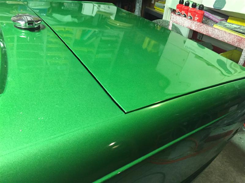

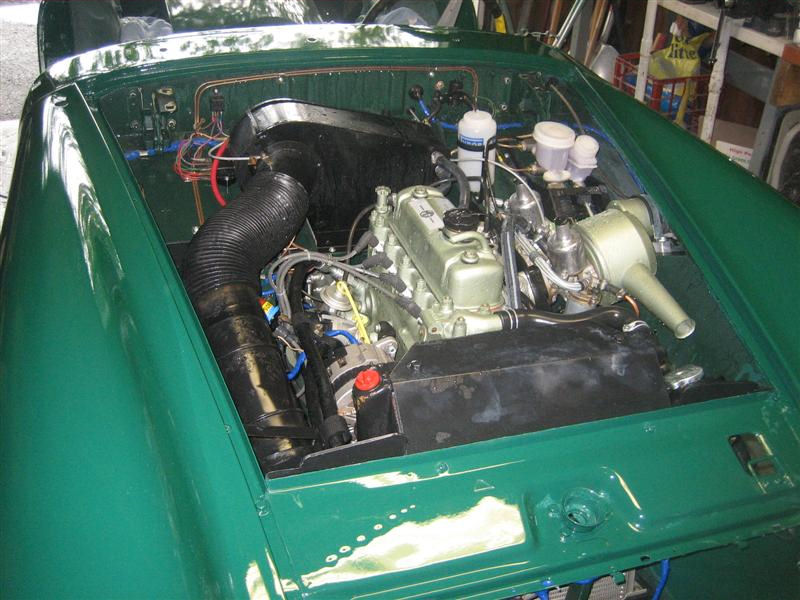

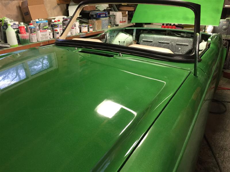

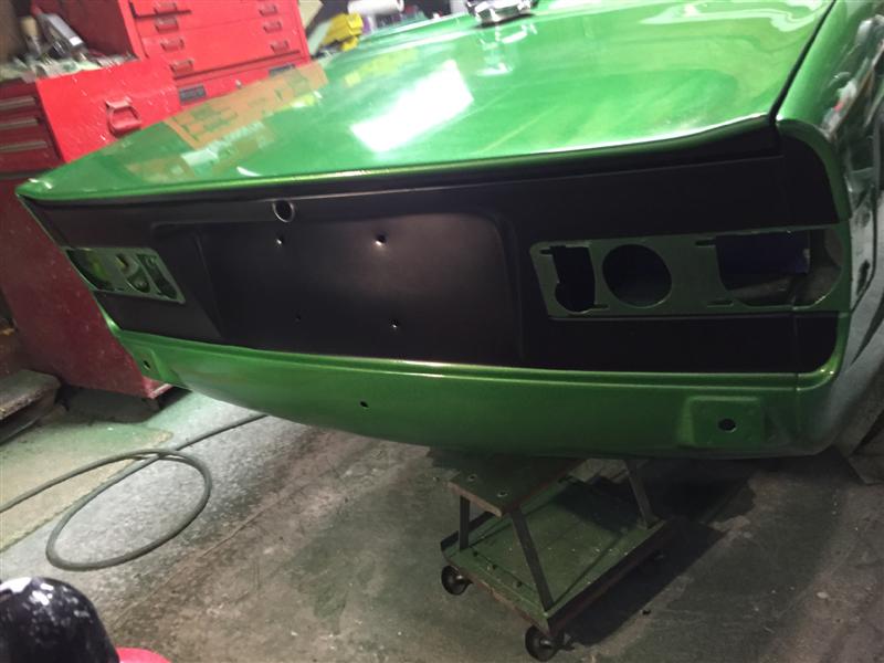

I have just finished the paint on my TR6 where it is sitting and did the Midget in that same space before that. It can be done.
