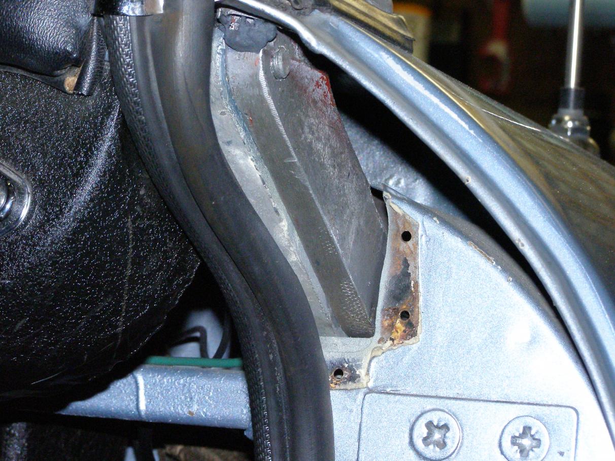

This job is made vastly easier if the covers over the mounting legs are removed. Doing so requires drilling out the rivets and popping the covers off - See the attached picture (if I can get it attached). The other thing that greatly helps, is to use a center punch through the screw holes to pull the legs into position.
Per "SU Dave" I have removed the covers on the front door pillar so I can actually see what's going on. I am waiting on a #4 pozidrive from Grainger to remove a bolt from the lower door hinge so that I can try the "one-man" system recently posted on the MGExp website.
