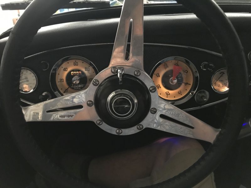

A couple of years ago, I had my tach out, and because the case was rusty, I pulled the guts out, repainted the exterior of the case in grey and painted the interior white. It made a huge difference in being able to read it at night.

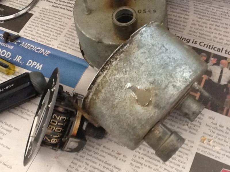

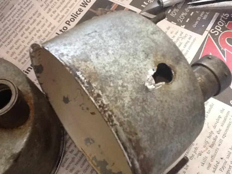

I elongate the hole that the reset shaft passes through so that the whole inside stuff stays together. A small cut off wheel on a Dremel works well. Once the insides are out, you can clean up the hole. After reassembly, foil tape works around the shaft. Good time to clean and lube the odometer gears.

I then painted the inside of the case white. Compare with the above photo of the speedo:

I painted the inside of mine several years ago by cutting the can similar to Bob's method, but I did a cruder job of it.
