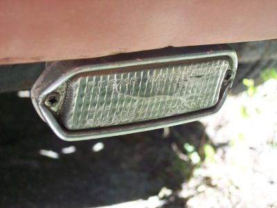

Since the BE never had a back-up light I thought it would make a handy addition (it is nice to be able to see while backing up at night!). My solution was the light below (an old Simca part!) wired directly to the reverse switch on the rib-case tranny! Works great!!
