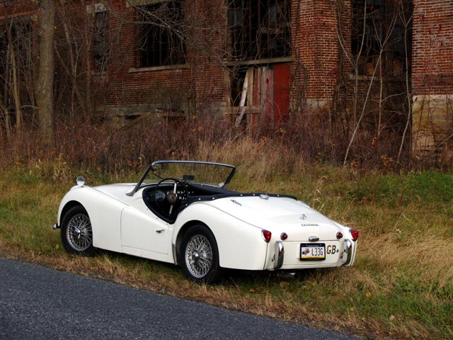

I had always wanted a LBC from back in HS when my friends had them and I got to drive my Dad's 64 Impala with the powerglide. In college, there were more LBC's on campus, and I had inherited my Grandpa's 52 Buick which I repainted to make it even more independent.
When I finally got the chance to make a Triumph purchase, I could not get the cut down doors out of my mind, and I ended up with Fagin, a 1962 TR3B. Keep looking and check out a number of cars. I was lucky to know a dealer of British Cars, and even if I paid a bit too much, I am happy with what I have now. Keep us posted on your shopping experiences...
Oh man, Randall and Dave's pictures sure make me want my old TR3 back!
