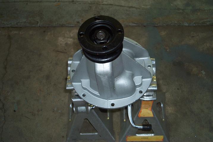

When I clean up diff, I first remove the front flange and seal, impact wrench comes in real heandy here. Then I just park them in the part washer for a day or so, then retreive them blow them dry, then I got one of those deep laudry sinks at the shop, i wash them a second time with hot water and sopa, prettyy much like I do engine blocks, then blow them dry again, and spray down the internal with WD40. I bead balst the front nut, lack waher and flange, the put a fresh coat of paint on them. I normnally paint the exterior diff housing with Dupli Color hi heat engine pait, cast coat aluminum, makes it look like fresh cast aluminum, and will stay looking like that. The install a new seal, and reintall the front flange. Here's photo of one done this way.

Hap, how do you hold the diff on place while you torque the pinion nut?
