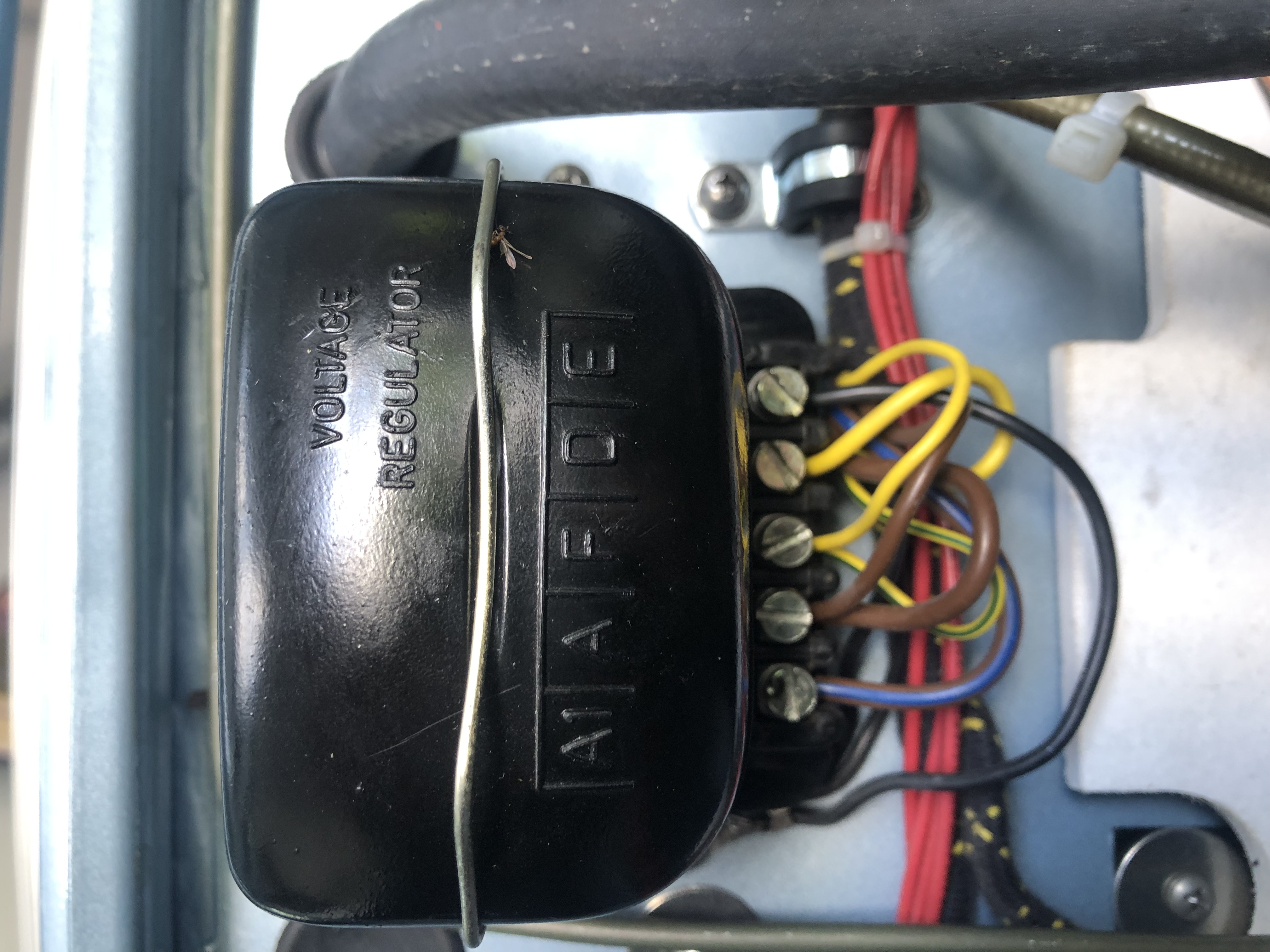

The dummy regulator box should have had the instructions in the box .
I was in the shop tinkering today ,took these pics for you. The dummy regulator is on my BT7 MK2 Tri Carb .

The conversion I made 20 years ago had no provision for mounting the coil. You will need to find a good place to relocate it. Not a big deal unless you have a conversion that maintains the old generator housing. I assume you have gone to negative ground. You could have taken your old voltage regulator, removed the coil solenoids, and just internally shunted across the terminals with a heavy gauge wire which is what I did. Its just cosmetic and keeps the firewall looking original. Its one of the best upgrades I ever did to my BJ8.

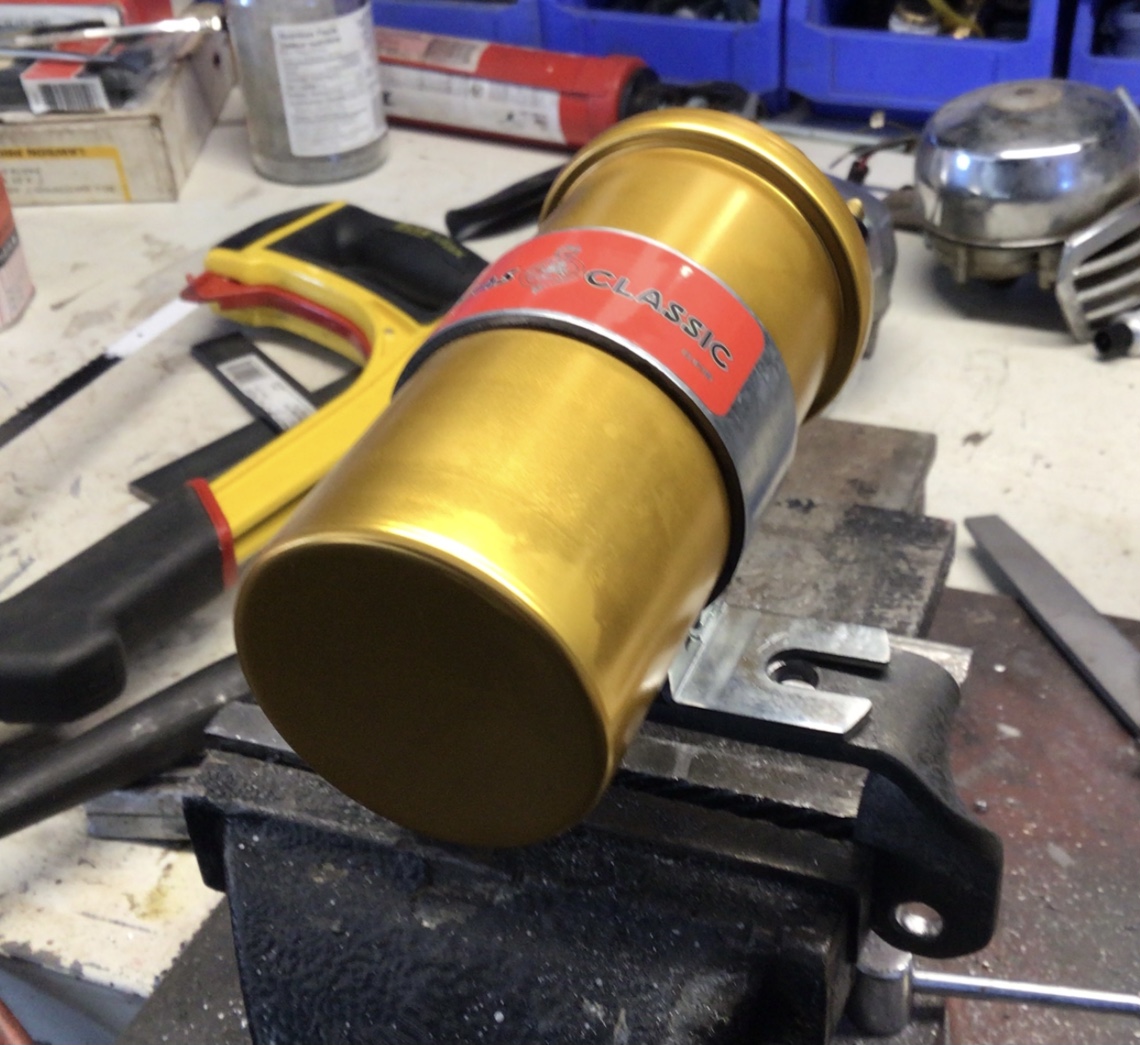

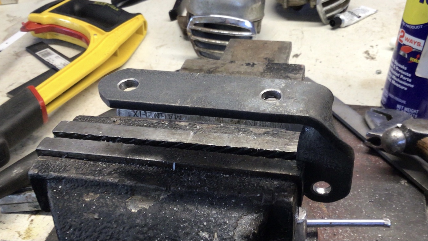

Yes you will need to relocate the coil if you’re using a regular alternator . Lots of ways to do it . Here’s how I did mine .
just made a bracket to fit on the new alternator mount so the coil sits above the alternator instead of the generator . Longer bolt needed for this .
