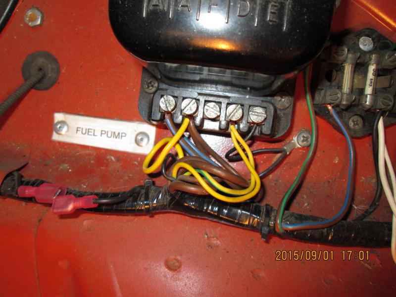

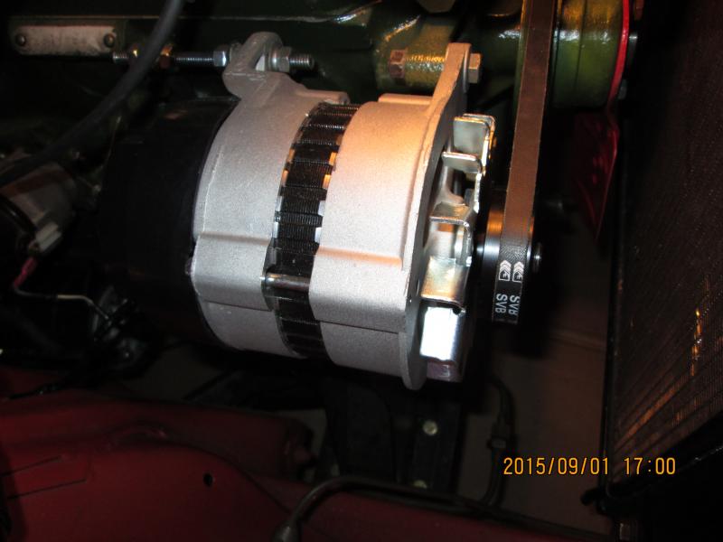

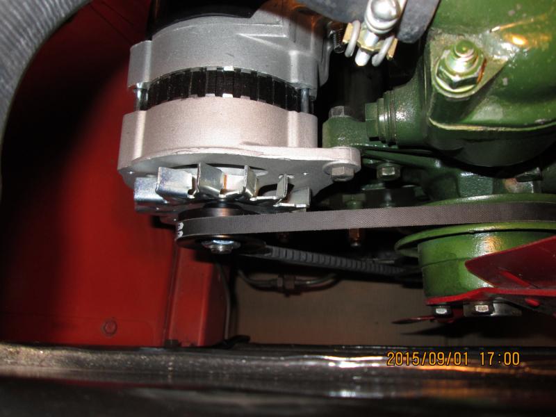

I've replaced the generator on all 3 of my recent "restorations" with an alternator--"full disclosure"--the cars were Nash Metropolitans--
The Met engine is the same as the MGA 1500, so it's a straight conversion using info from the MGA guru website--
I bought all 3 alternators on ebay-for $60 to $90-+(MGA-MGB-MG Midget-Triumph)---they all came with the fan installed--proper bolt adaptor in the rear,
fan belt, and
adjusting link at the front--The info on the website shows that only 2 wires from the generator have to be moved on the regulator--
www.mgaguru.com type in search box AC-101--Generator to Alternator conversion--
