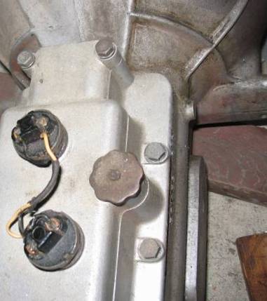

here i go, doing it myself. if someone has a pict of top cover with switches would appreciate. and which is what and what thread? 3 spots 2 switches? also dipstick with dimensions on dip to fabricate to see if i can cram it it there while at it. then there is the stuff inside. details, details.......................thanks
Here's a shot of the switches. The leftmost switch spot is for a reverse light, so you can leave it out if you don't have one. The thread is M16x2.

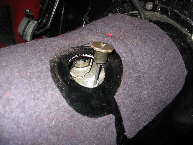

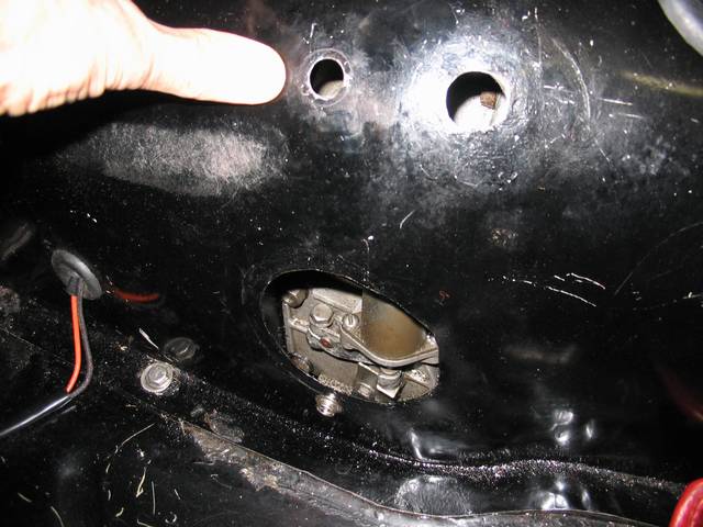

I added a large hole with a large rubber plug for easier access to the solenoid on the left side. I also cut two smaller holes ( filled with rubber plugs) way up above the screws for access to the screws using a very long screwdriver. And I use regular slotted round-head screws to hole the solenoid that I can easily un-screw with the long screwdriver.

Wow, Don, do you really mess with the solenoid that often?!
Pulling the tunnel is no fun, I'll admit, but once it's set up you should be able to go at least 10 years without touching the OD other than changing oil.
