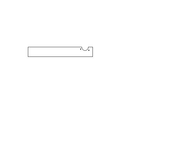

They make a special tool to hold the shaft from turning. I figure if I had access to some metel fabricating tools I could make something... You might be able to fashion something out of a 2x4 board... maybe cut a hole into it to fit the socket through and literally bolt the board to the end of the shaft. Or (easier) cut a semicircle out of the side of a 2x4 and bolt two bolts of the flange to the board... see attached pic for a description of my idea.

Actually, that sounds like a good idea. If my neighbor can't help me tonight, then I may have to do that.
Yeah, I understood the concept of using the screwdriver to hold it in place, but it bent then popped out of the handle. I figured I would just wait until I could get some help before I killed myself.
