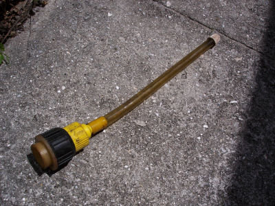

I never have to go under the car (except to drain the tranny)!! To top up/fill the tranny I use this... /bcforum/images/%%GRAEMLIN_URL%%/thumbsup.gif

My point exactly...THANKS...a wrench and a pour
and she's filled....I'll stick to the gearshift...
