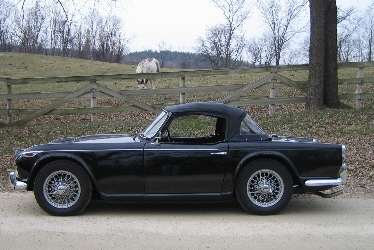

Made one stop for a photo.

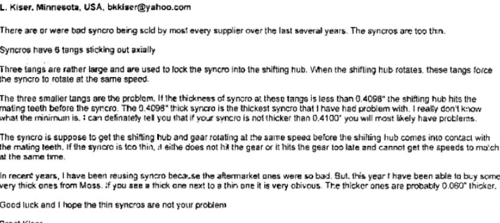

There was abad batch of about 10,000 synchro-rings made about 10 - 12 years ago and they were too short in one dimension. They caused a lot of "knashing of teeth", both in the gearbox and for all those TR owners who had them installed.
Here is what I still have in my files written about 8 - 10 years ago by Brent Kiser.
