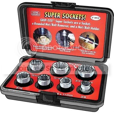

These might get you out of a bind. They have me. Got mine at Sears.
