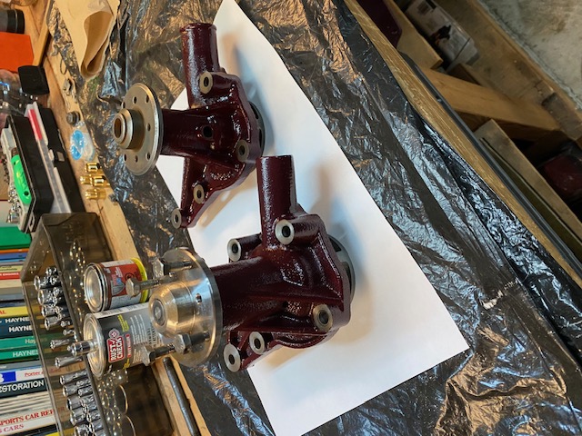

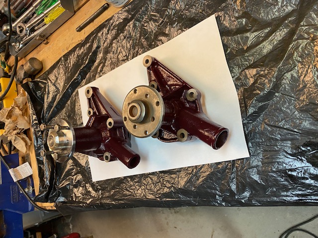

I was hoping to make my 1966 MGB GT look as original as possible, but I have replaced the original engine with an 18V block. Is it possible to mount a GB waterpump to this block or is this a no no?

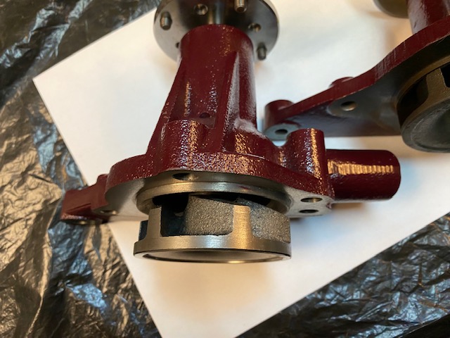

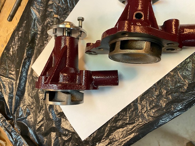

The holes appear to line up, but the vanes extend into the block further with the GB pump.

No definitive answer for you. But a couple of questions. Did all 18V engines have electric fans in front of the radiator? Are you going to have a pump mounted fan? If so, I'd use the GB pump, if it doesn't put the fan too close to the radiator. On the other hand, I'm a bit surprised at the gap between the vanes and the body of the GB pump. Please take this with a grain of salt.
I didn't think any MGB's came with an electric fan. It would be an aftermarket upgrade. I agree that it is a bit strange that the new GB pump vanes extend that far from the base of the pump.
