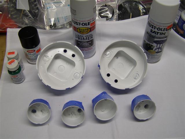

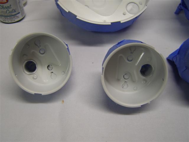

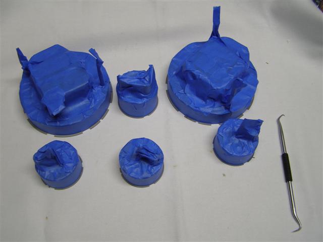

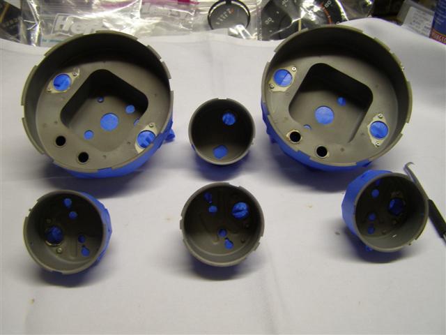

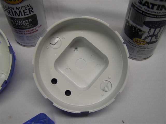

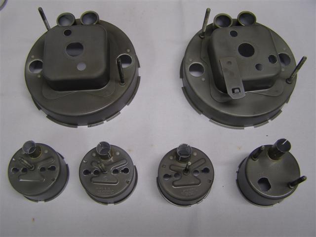

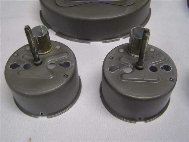

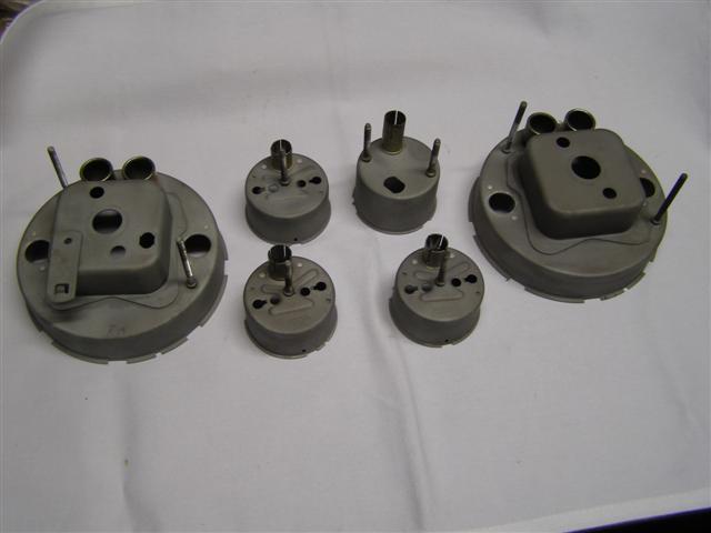

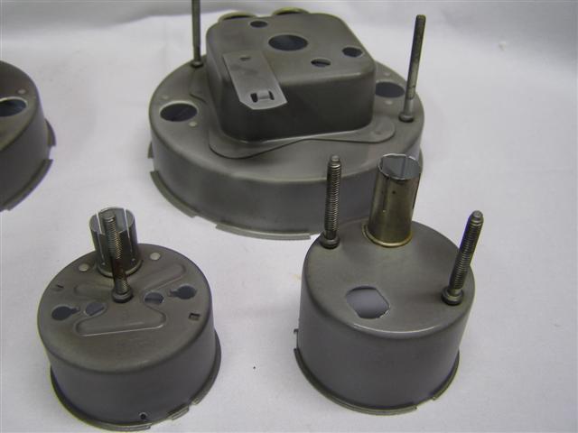

OK, so far so good. My buddy bead blasted these housings for me, so the old crap is off and new paint is on and drying. Then I'll clear coat the backs.
I decided at the last minute to get rid of the reflectors and try a few other options for coloring the back lighting.

Re: Gauge restoration/housing refinishing up-date
They look Marvelous..........

I got the idea from some famous restoration guy in PR and confirmed it with another in CA on the 6-Pack Forum.
Now we've even got a guy in Israel doing his over. See what you started, Dale?
A little clear coat on the backs and cleaning of the over spray in the small gauge light tunnels (it screws up the ground for the lights) and we're good to go.
Oh, you can't see it in these, but I also hand painted the (4) tunnels at the bottom of the big gauges white inside for better reflection on the high beam, turn signal, oil, and ignition lights.

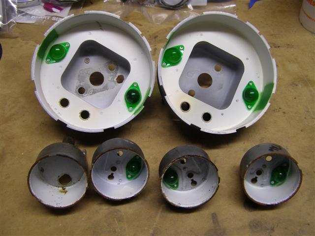

Dale,
Did you paint a small area on the sides of the housing where the bulbs come through as shown in my upper most picture in green to deflect a glaring light from the direct unfiltered bulbs?
One of the guys on 6-Pack painted his flat black to do just that.
The half blue and white mentioned above was probably to lend a soft blue tint to the lighting. Dale's had blue lenses and mine were originally green, but I like the look of the soft white and it makes the lettering and numbers stand out better IMHO.

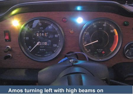

Me too Paul-
I wired my gauges into the dash in my living room and tried
various combos of lights/filters etc with a 12V motocycle battery.
I liked the 2.3w Lucas, in semi-gloss white, the best.
Your taste, try different combos.
Here's my final, installed:
Suits me just fine here on the island.
regards,
d
