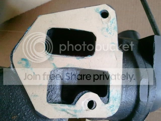

Whack one out with a six-ounce ball-pean and a roll of NAPA gasket material, Don!

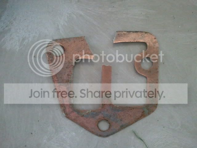

It's not the WP gasket.
It's the housing to the engine side

Or if you don't have the gasket material handy, a piece of dense (not corrugated) cardboard will work. Eg a shoebox, or the cardboard sheet that comes with pads of notepaper.
right..... still don't have that one.
A thin coat of a gasket maker such as The Right Stuff from Permatex will eliminate the need of the fiber gasket.
I have gasket material so I guess I'll make it. Should I put the "Blue" stuff on it?
