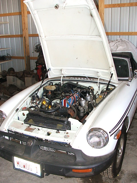

I just installed a set on my '76 B. I must say that I absolutely love them! They make access to the clutch reservoir much much easier (the hood opens much higher with them). Plus, (not that this'll happen much, if at all) I don't have to worry about unidentified garage employees bending the hood because of their lack of observation powers.

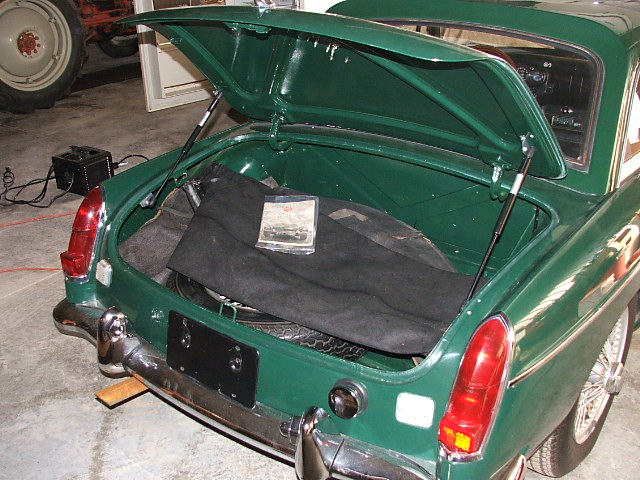

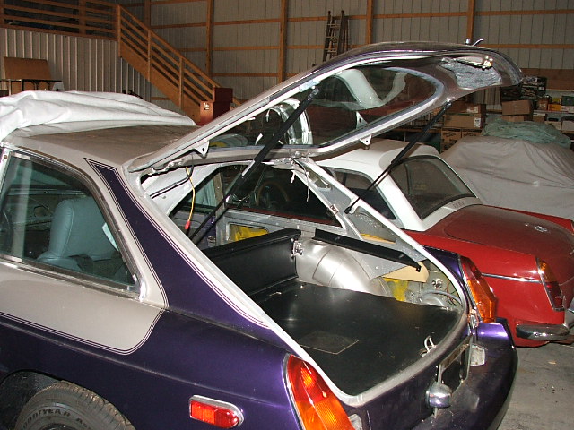

I offer them through Pieces of Eight.
I recommend their use on STEEL bonnets only, not aluminum.
I also offer them for bootlids and GT hatches.
COntact me via PM and I can send you pricing information.
Pieces of Eight!
Struts for your M.G.

Hey Rick,
When I installed the struts on my 80B bootlid, with the lid in the closed position, it actually lifted the front edge of the lid a good 1/8". Raised the lid off the surrounding area by the 1/8" I mean.
Is this common? Will this settle down as the struts wear in? I love the struts for the bonnet, but removed the ones for the boot after i noticed the problem.
Thanks in advance for the response.
ICESWH said:
Hey Rick,
I've not experienced that problem with the installs on my two MGCs nor my MGB. Only other problem that I've learned of was on a 1980 MGB that had a pre-1972 bootlid on it...and the mounting position on the bootlid inhibits complete closure of the lid. This was fixed by moving the lower ball brackets down on the channel somewhat.
It sounds as though the lower brackets on one or both sides *may* be mounted too far up the channel on your MGB. The bootlid may also be somewhat out of true.
Please contact me off-list if you wish....we'll try to work something out.

I absolutely recommend them for steel hoods & GT hatches - especially GT hatches! Mine have never affected the fitment at all - must be something else.
