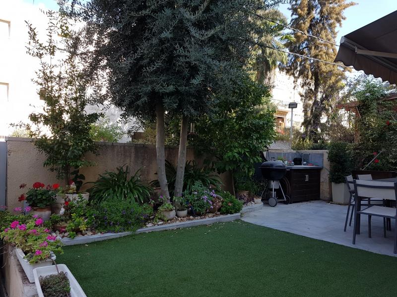

My driveway is quite visible since it is the entrance to my apartment and attached to the garden so I had to make it look nice.
I put large grey tiles on the driveway several years ago, park on it daily and have used jacks, stands etc on it many times. I haven't bothered with plywood and there are no signs of damage. I just power wash it when the van has leaked enough to be noticeable stains will come off with engine cleaner. Get GOOD quality tiles , and make sure that they are slip resistant.
Got pictures?
