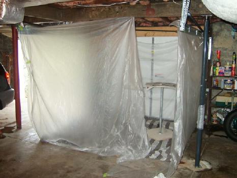

Well, since we're on the topic of painting in the ol' garage, thought I'd send along a photo of my homemade spray booth where I've been working on priming my rostyle wheels. So far, it's worked pretty well. As soon as this rain here in Nashville goes away, I'll get ready to spray paint on those wheels and get them ready for the body shop to put on!

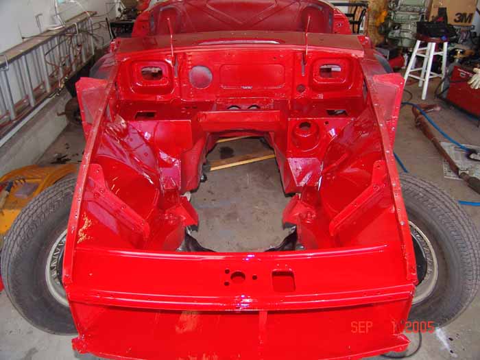

I just repainted my engine bay and trunk in my garage today.

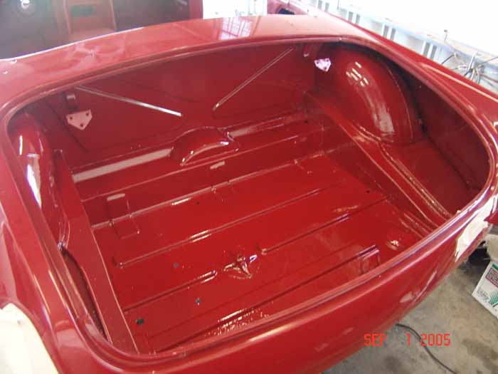

Here is the boot.
