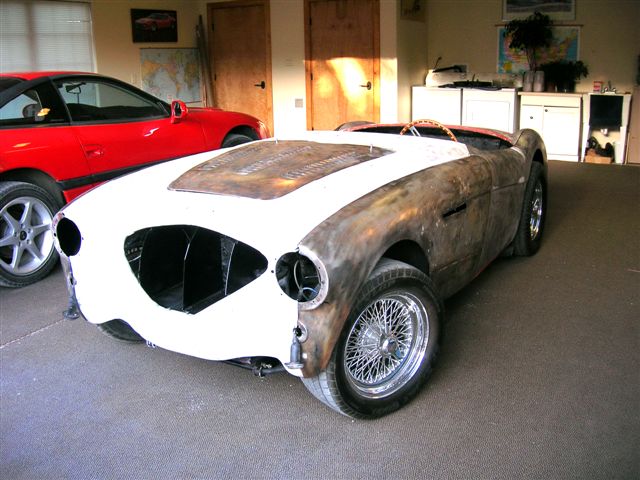

..I am still very happy with the cheap indoor / outdoor carpet I put down over 5 years ago, when this photo was taken.
It made the garage so much warmer, nice to lie on etc.
Since my Healey has a Chevy, it doesnt leak oil ;-) and the Stealth certainly doesnt, so no problems there.
...And the cat loves it to scratch on it also, saving the rest of the house!!
