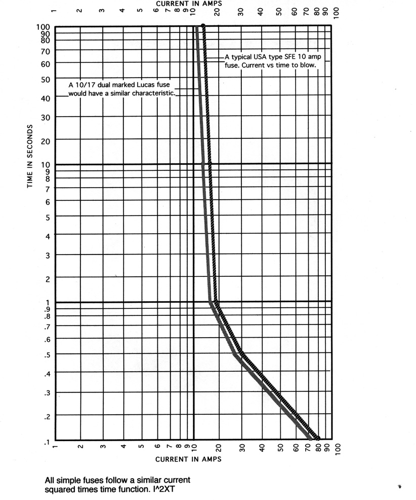

Hi Steve,
The attached graph shows the actual time to blow vs current for a typical simple fuse such as found in our cars. It also shows the comparison between a Brit rated fuse & a USA fuse.
It is true that repetitive overloads are cumulative on the simple fuses. The typical simple fuses under discussion are considered fast blow fuses. The higher the overload or the longer the time, the sooner it will blow. This DOES degrade the original fuse rating & fuses that are subject to overloads should be periodically replaced before they blow at less than their original rating.
In some applications, such as electric motor starting, there are slow blow & other variations of time delay fuses that do not degrade as much with repetitive overloads. As you say, even these are often replaced as preventive maintenance.
D

Steve_S said:
Isn't that basically what I described? You're saying that carrying 25 amps for a certain amount of time will blow the fuse, once significant heat has built up. Now assuming 25 amps is put through for less than that amount of time, but dozens of times over, it seems safe to assume the fuse will be somewhat weakened. I don't have scientific proof to back this up, it's just what I've read and what I've been told by the "old timers" over the years.
I doubt that the fuse will be weakened. This is because the automobile designer counts on the wire harness resistance to limit the transient type current to his fuse. This simply says that current in the non inductive circuit can not go from zero to infinity in zero time as it is limited by the wires resistance. For inductive type circuits; motors, solenoids etc, they should use a slow blow type fuse. But that's another issue.--Fwiw--Keoke
