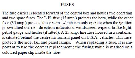

I cant seem to find anything on what size fuses to put in the TR3, not even in the manual. Any help would be appreciated.

Just remember you want British standard fuses, not American standard fuses.
Or, if you do use American fuses, they should be rated about 1/2 what the Triumph documentation says!
Here's the fuse description from Practical Hints (the drivers handbook that came with the cars) 6th Ed (which I think was the last edition). Some earlier editions specified a 50 amp fuse for the horns.
