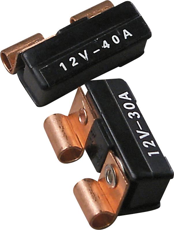

This type of problem can be difficult and expensive to track down as you keep blowing fuses before you can really do any fault isolation. I'd recommend getting an automotive circuit breaker that will snap in in place of the fuse and then you can reset it each time it fails by just removing the battery cable for a second. Try removing one connection at a time from the bad circuit at the fuse block, when the circuit breaker doesn't blow you have isolated the main circuit, not you just have to follow that out and isolate each individual component until you find the short. The circuit breakers should be available at your local auto parts store.
who knew - thanks Bill

The resettable breaker that replaces the fuse is another option, and might be a good thing to have, in any case.
