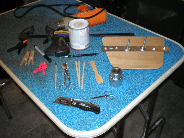

You can try to pester me into doing it, but I've got pretty thick skin. I could probably be talked into doing another one, and I know I could do as well a job in a fraction of the time. -I probably threw the 'jig' away that I jerry-rigged, but since I used a scrap of drywall, it would not take long to make another. I'd probably spend more time trying to remember how I did it, than actually doing it. But if anyone wants pictures of my process, I still have them.

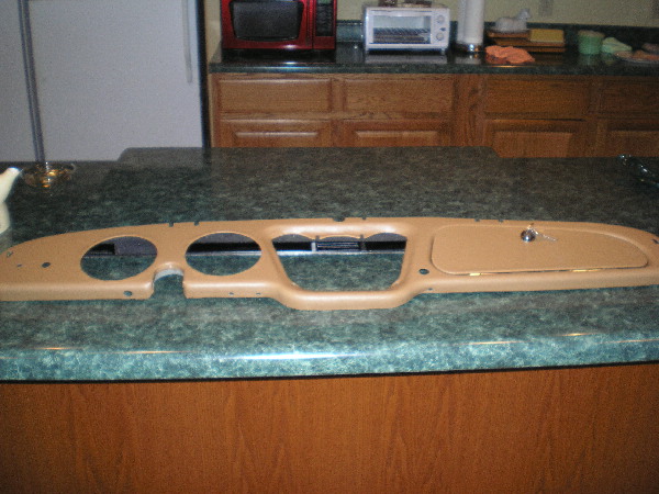

I never really understood the issue with the primer getting soft. I stripped off the whole mess, and started over with another paint. I assumed Eastwoods primer was better than what I had the first time. The second time around, I had no softening of primer, and no material pulling the primer off the dash.
I used no heat, but will see how that works out on the capping.
