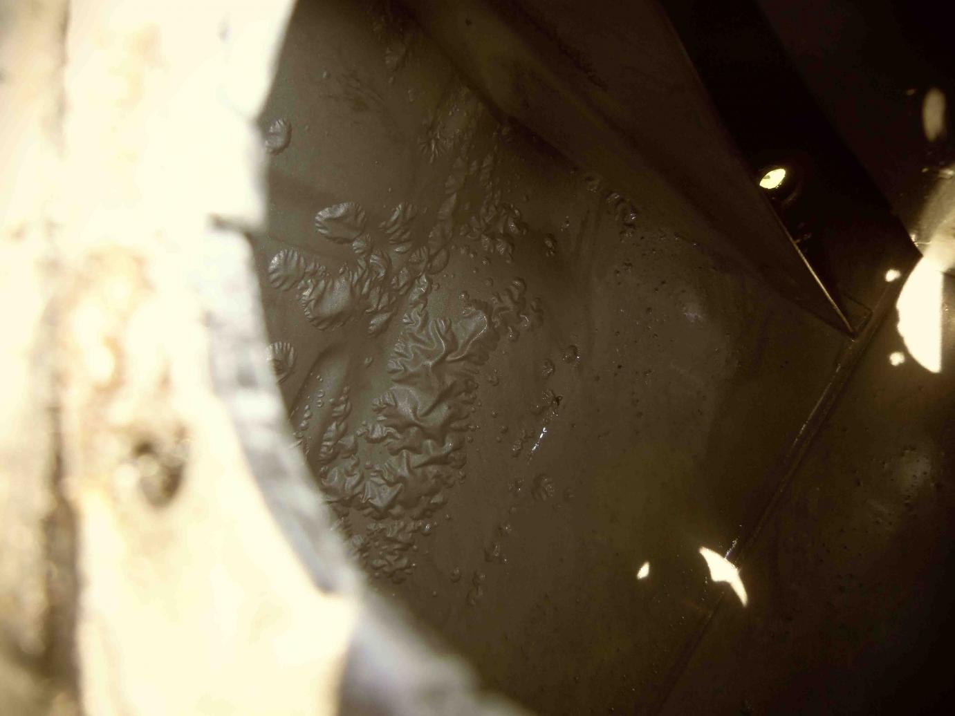

This is a pic of the inside of my tank. For years there was a product that was used to coat the inside of gas tanks made by POR 15. It was their silver coating and they no longer recommend it for that use. I'm living proof and it's probably because of the alcohol content in the gas. Did everything right too. I remember cleaning it well and etching the metal. It cured for months too.
The problem started then I would drive the car and it would die out in the same place and having to limp it back home or tow it. The coating was lifting and coming loose then plugging up the outlet hole not letting enough fuel to reach the pump. Anyway I'm getting a new tank tomorrow and that should cure it.

I have had mized success with tank coatings, on my Healey 100 I coated the tank with the Bill Hirsch product after I was getting a lot of rust silt in my gas, and drove it for nearly ten years after that with no issues whatsoever. I coated my TR250 tank with the same product and had trouble with it flaking off and clogging the tank just as you describe, but I later figured out that the tank had previsouly been coated or sealed with something, and I think the previous coating was more of the problem.

Got_All_4, how many years ago did you coat your tank? I have one of the tanks in my Mini coated with POR but it is not their silver paint. I used their tank lining kit which uses a similar but more elastomeric coating. I have had better luck with it than with Kreme products (the white tank liner). My POR lined tank has been in service for about 9 years now.
POR still sells the material I used both in quarts and in complete kits. They specifically mention it is compatible with fuels containing alcohol.

Personally I'd never coat the inside of a tank be it with a kit or having it professionally done. All it takes is one tiny 1/4" piece to flake off and your outlet is clogged and you've got a flatbed ride home..... in almost 16 years, the only time I didn't make it home on my own was due to the outlet getting clogged.

No argument that it's a fraction of the cost of a new tank for any car but, going back to my original statement...... all it takes is 1/4" of material to flake off and clog the outlet and you're dead in the water.... so to speak. Been there, done that and ain't never going back. It's the old risk reward decision...... the irony of the clog in my tank was that not even compressed air blown through the outlet would dislodge the crap..... nor would a coat hanger. I had to pull the tank, remove the sender and grab my 36" push to grab grabbers to pull it out. My only point is that anyone considering an internal coating needs to think it through before going that route.

I took my old, tank, the one that had been coated, to a shop to get boiled out, when they discovered it had been treated they said they couldn't do it, when pressed they said they could, but the price would about triple and they couldn't guarantee the results. I think the coating can work if the tank is very well prepped, but if you have it that well prepped, removing all the rust, don't know that it would be necessary to coat it. I have had a couple tanks with these types of issues over the years, if the car stalls because of it, if you sit for a few minutes their is no longer pressure holding the flake or debris in place and you can usually soldier on for a while until it happens again. If that doesn't work you can reverse blow some air into the fuel line by disconnecting it at the carbs, if you don't have compressed air and don't mind the taste of gas, you can blow through the fuel line. I limped home from a track day last year, where the sloshing around really broke up a lot of debris, by doing just that. Ended up going 50 miles about 3-10 miles at time, but got home fine. Replaced the tank and used the rock method described above on the new used tank, no problems since.
