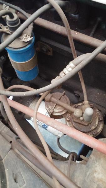

I was wondering if someone could verify what the actual OE fuel pump looked like? Was it the AC pump that some of the big 3 mention in their catalogs/online or is it the one I have in the picture attached? I noticed that some of the repro's have a lever for priming, but also seem to have a 3rd hole. Or is that third hole plugged and is just something in the mold of the top? I'm trying to source an OE AC pump and then will do a rebuild kit (probably TRF since it is more complete, but way more money than Moss' kit) if someone will confirm for me that indeed the AC pump is the original type. Thanks again for your help!

Original fuel pump (still) on my TR4 is AC with a priming lever.
I think I know what you mean by a '3rd hole' -- there is what appears to be a casting for a connection just opposite the connection for the output line but it is a dead-end, i.e. blocked and unthreaded.
I'll look for a photo or wander out to the garage & take one.
Now that repro pumps with priming levers are available (they weren't for many years) original pumps may be easier to find. So simple to rebuild there is possibly no reason to settle for a reproduction.
Having wandered out...
Original pumps are marked 'AC' on top, do not know if reproductions have this.
Don't know if mine is original, but it looks identical to Geo's but is marked "BCD" and does have a priming lever.
EDIT: It seems the BCD is an Italian-made clone of the AC pump.
Perfect. Thanks guys. I love this place! I found a used one, so now to go OE and pay more for the pump and rebuild kit or just buy a reproduction one. Hmmmm...the purist in me says OE. HAHA
