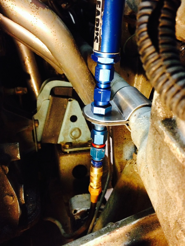

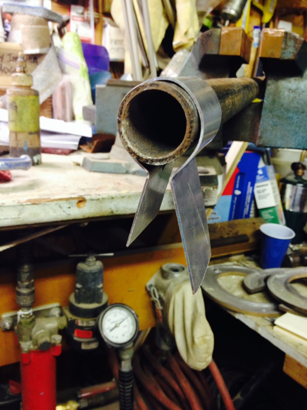

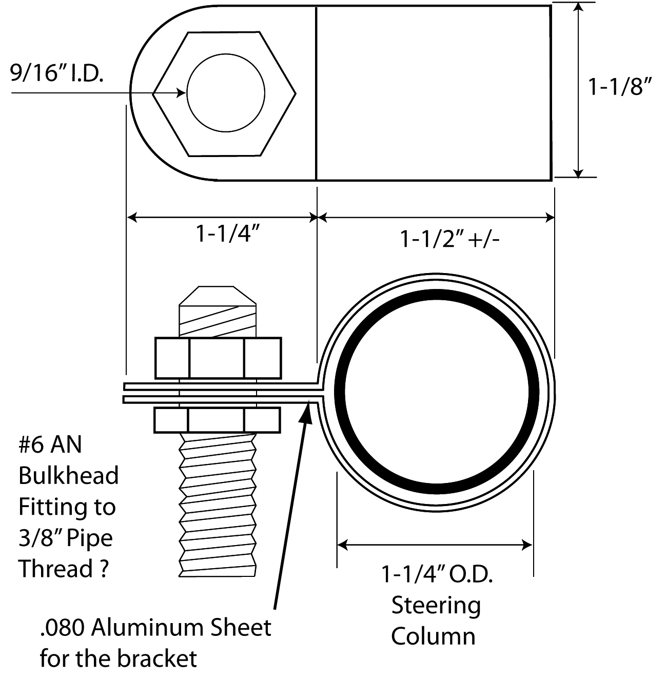

Unless you want to run the hose all the way to the carbs you'll also need a compression fitting from #6 AN to 3/8" hard line.
