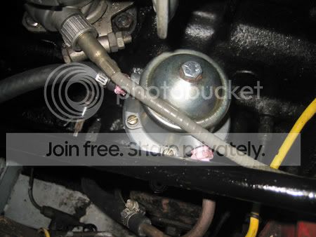

Fuel pump rebuilding 101

well, i'd love to use that to assist me in rebuilding my pump soon but you're missing pics already. the very useful ones for valve reinsertion and such. fantastic job otherwise, and is very useful.

The valve reinsertion is simply a tap in with a socket. Perhaps I should have stated that, but I assumed that it would be easy to figure out. What else do you feel is missing as part of the "and such" in your statement above? I may additional pictures that I can insert.
I thought that this would take the major questions away from this job, but perhaps it's missing something. Feel free to advise.

Is that Jeff Palya's work with the polishing? Nice work whoever did it!

Your pump looks identical to mine!!

Yes Shannon, it was Jeff Palya's work.
Dale, yours is the "younger brother" mentioned in the apge.
first, i'd like to say this service to the triumph community in general is priceless. second, all the pictures showed up in my browser this time and everything makes sense now.
I was really hung up on how you removed and replaced the valves, being that they are delicate pieces and the body is aluminum and thus soft. it must have been a mix of my browser not recieving all the pics and the late night reading through almost all your pages of valuable information.

Hey Flinkly, no problem. I thought that I had really missed something from the way it sounded. BUT, with that being said and in all fairness to you, I will correct the installation of the valves to make more sense. I really didn't take pictures of that or couldn't actually because I was a one man show doing it and I couldn't hold the camera and have a hammer and socket in both hands at the same time.
