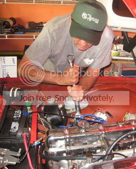

Here is my electric pump installed. Will this setup get
me home?

Didn't you try this pump already, when you installed it? If it gets you running in the garage, it will get you hpme. More worries about excessive fuel pressure with electric pumps than not enough.
I see that you are tweaking the adjustment in the picture above. Did that adjusting tool come with the new pump?
The electric pump runs fine. I never connected it to the gas tank.

Banjo instructed me to purchase that adjusting wrench to properly
tighten down the carb dashpot dip sticks. I couldn't get enough
torgue wiff me screwdriver.
