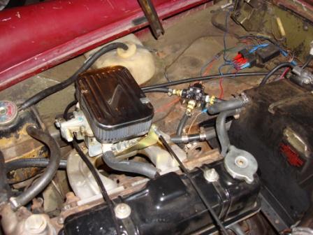

I went with an electric pump Dave. I'm glad that I did now that it is done. I was having nothing but trouble with the mechanical pump. I also used a Holley low pressure fuel regulator. The pump I bought was putting out around 4.5psi. I think it was fine for the Zenith carb but once I switched to the Weber, it over drove it a bit.
JC
I'll shoot some tonight. It isn't the prettiest in the world. I mostly just put stuff where I could fit it for now. Planning to disassemble the whole tub at the end of this summer.
JC
Here is what I have right now. It is just a work in progress. Mostly trying out things to see what works best. It is in no way ready for pictures that I would consider showing off but since you asked. I didn't expect the fuel regulator to be so large. You can see the regulator and kind of get a reference of the size based on the stuff around it. Also you can see the top of the fuel pump just peeking out past the heater hose. I mounted the fuel pump on the inner fender well and fabbed a quick heat shield to protect it from the header. I'm making a bracket to put the regulator deeper under the fender but didn't have the metal at the time.
