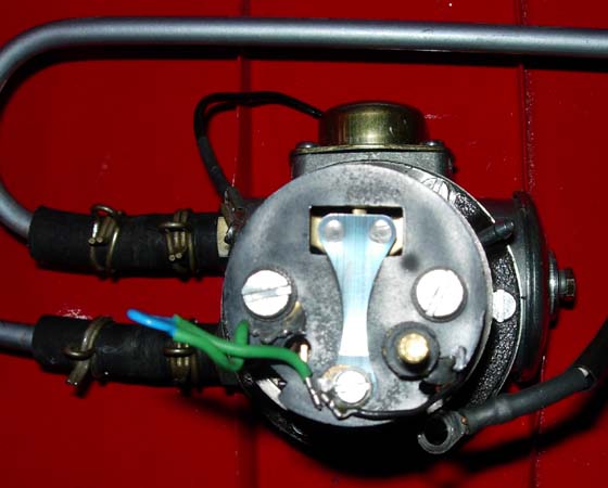

Does yours have a diode under the cap like the one in the attached picture?

That's right. If the fuel pump has an arc surpression diode, then the polarity would have to be swapped when the car is changed over to negative ground. If not, then the diode cannot perform it's intended function of arc surpression and the result would be a set of burnt points. Look and see if your fuel pump is the kind with the diode. Some have a capacitor and they are not polarity sensitive.
Hi Kevin, I have been wondering how the current points type SU pumps supplied now are not polarity sensitive.Perhaps the "Manufacturer" has reverted to an earlier mistake and removed the arc suppresion components from the pump.I would stay with the SU pump but use the electronic version, they will give you years of trouble free service.---Fwiw---Keoke

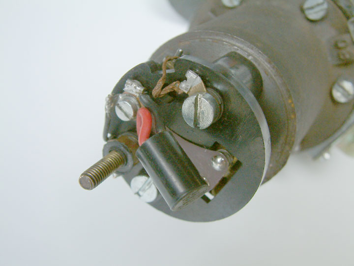

To all, attached is picture of the internals of the pump. although I am hazy on the terms diode and capacitor this pump does have an item between the pump body and points. it does not appear to have any terminals left over where a diode was removed. the tech article looks fairly simple and I may go in this direction.
I purchased this pump as specific to a negative ground car. the price difference is what made the decision to go with points assuming they have worked for the past 50 years.

Hi Kevin, if that is all the components under the cap in your pump then my suspicions might be correct. The "Manufacturer" has removed the arc suppresion components from the pump to allow its application to each ground system. The addition of a Mylar; 0.047 Micro Fd Capacitor with a peak inverse voltage of ~ 600 Volts across the points will solve its problem. --Fwiw---Keoke
Kevin,
In your pic of your fuel pump, what is the light blue item in the middle of the green wires ? Is it a side view of a little capacitor ? Are there numbers on it ? In your pic this item looks like the side view of a small capacitor. We are just curious what the current stock is using....
